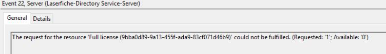

- If a user is registered using SCIM, but there were no more licenses available, then the event description will look like this:

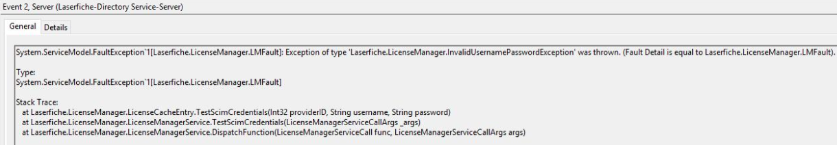

- If the Basic Authentication credentials are changed in Directory Server, but not in Okta, then the event description will look like this:
