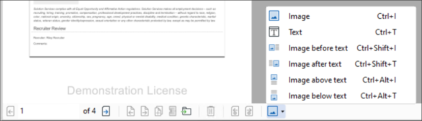

Once you have scanned a document, you can review its pages and (if you chose to generate text) its text. By default, the images will display in the center of the display. You can also click the mode button at the bottom of the screen to switch to viewing text, and you can use the page arrow buttons to move from page to page.
If you have scanned multiple pages, you can use the larger arrow buttons to move from one document to the next, or you can select a specific document under Revision on the left side of the screen.
