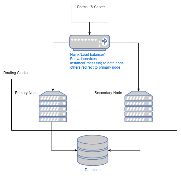

Basic Architecture
To setup Routing Service cluster, you will need following:
  1. Multiple machines with Laserfiche Forms installed
  2. A tcp/ip layer load balancer (such as Nginx, NLB, or F5)

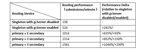

Performance Benefits
Based on extensive testing, the best cost/performance benefits can be obtained when the following routing service deployment recommendations are followed:
  • For low load (0~480 submissions/minute), deploy with a singleton routing service.
  • For medium load (480~960 submissions/minute), deploy distributed routing service with a primary node and one additional secondary node.
  • For higher load (>960 submissions/minute), deploy distributed routing service with a primary node and two additional secondary nodes.
  • Deploying a distributed routing service is likely to hit a bottleneck at the SQL server. To alleviate this issue, use SSD for the Forms database storage.
Below is a brief example of performance gains using Routing Service Clusters when processing form submissions with 100 fields:

If you need to setup a cluster for the Forms IIS Server as well, you will need to setup a separate NLB cluster that hosts the Forms IIS Server nodes.

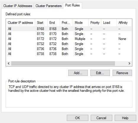

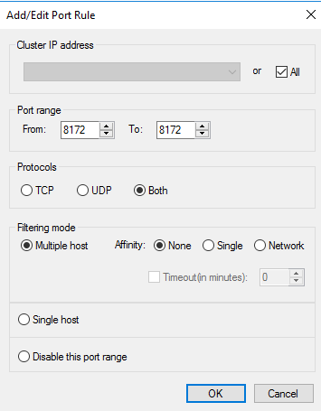

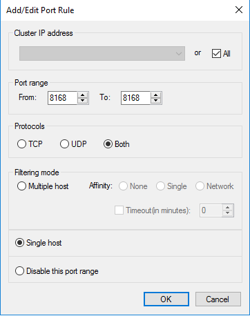

  5. Configure the cluster port rules in Cluster Properties:
    1. For port *8172/8176, follow the image below:
    2. For all other ports (8168, 8170, 8732, 8736, and 8738) follow the image below:

Using Nginx, you can make multiple Laserfiche Forms instances (including Forms IIS Server and Routing Service) perform in a clustered environment.
General configuration
For a Forms cluster to work, you need at least 3 machines (two machines hosting Forms instances and one machine hosting Nginx). Before starting the configuration ensure the following requirements are completed:
  1. All Forms servers must have the same date/time settings. Sync all server clocks before proceeding.
  2. Nginx is hosted in a separate machine, and it is recommended that the latest official, stable version of Nginx is used. Download the latest version here.
  3. Ensure that the Nginx machine can access ports in all Forms machines (ports 8168, 8170, *8172/8176, 8268, 8732, and 8736, you may need to allow firewall exceptions manually. See the note above regarding port 8172/8176.)
  4. The Laserfiche Notification Master Service and Laserfiche Notification Hub Service may only be hosted in one cluster node. In this documentation, it is assumed that these two services are hosted in the primary Forms node.
Configuring Nginx
When acting as a load balancer for Forms, Nginx has two primary functions:
  1. Redirect http/https requests to the Forms Cluster.
  2. Redirect wcf requests to Forms Cluster.
The configuration file (nginx.conf) will be similar to the following sample. The http section performs load balancing configuration for http requests, and the stream section performs load balancing configuration for wcf requests. Replace primary-address with the address of the primary node, secondary-address-1 with the address of the secondary node, nginx-host-name with the Nginx machine name, path-to-crt-file and path-to-crt-key-file with the appropriate paths (See the note above regarding port 8172/8176 and set instance processing ports accordingly):

# configuration for wcf nettcpbinding
stream {
# enable these two lines if you would like logging for requests
# log_format	basic	'$time_iso8601 $remote_addr '
'$protocol $status $bytes_sent $bytes_received '
'$session_time $upstream_addr '
'"$upstream_bytes_sent" "$upstream_bytes_received" "$upstream_connect_time"';
# access_log  access_tcp.log basic;
	#lfinstance
	upstream instanceprocessing {
		server  {primary-address}:8172;
		server  {secondary-address-1}:8172;
	#lfrouting
	upstream routingprimary {
		server {primary-address}:8168;
	#lfautotrigger
	upstream autotrigger {
		server {primary-address}:8732;
	#lfformexport
	upstream formsexport {
		server {primary-address}:8736;
	#attachmentTransfer
	upstream attachmenttransfer {
		server {primary-address}:8170;
	#notificationservice
	upstream notificationservice {
		server {primary-address}:8268;
	server {
		listen       {nginx-address}:8168;
		proxy_pass   routingprimary;
			# uncomment following 2 lines if you want wcf call return
			# immediately when Routing Service node is down for some
			# reason instead of waiting for a 1-min timeout.
		#proxy_timeout 3s;
		#proxy_connect_timeout 1s;
	server {
		listen	{nginx-address}:8172;
		proxy_pass	instanceprocessing;
	server {
		listen	{nginx-address}:8732;
		proxy_pass	autotrigger;
	server {
		listen	{nginx-address}:8736;
		proxy_pass	formsexport;
	server {
		listen	{nginx-address}:8170;
		proxy_pass	attachmenttransfer;
	server {
		listen	{nginx-address}:8738;
		proxy_pass	licenseservice;
	server {
		listen	{nginx-address}:8268;
		proxy_pass	notificationservice;
