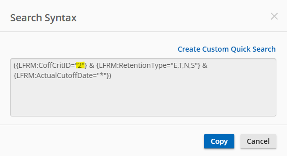

Viewing the Search Syntax for an Search
When performing an search, you can view the search syntax for the search as you create it. To do so, open Search Filters and click Show search syntax at the bottom of the dialog box. This will display the syntax for the search you currently have configured. As you make edits to your search, the syntax will automatically be updated. This is a useful way to learn how to create a search syntax search. You can also copy the syntax from this box and paste it into the Search syntax search option, and then fine-tune it without having to write the syntax from scratch.

- { LFRM:CoffCritID="ID"}
ID represents the automatically assigned ID number of the cutoff instruction.
Tip: Locate the cutoff instruction's ID number by searching for the cutoff instruction from the Search Filters Pane and opening View Search Syntax from the More options menu.
Cutoff instruction type:
This search will return records that are assigned specific types of cutoff, such as Event or Time+Event cutoff instruction. If you select more than one cutoff instruction type, results will be returned for either.
- {LFRM:RetentionType="Value"}
Value specifies whether search results will contain records with Event-based cutoff instructions, Time-based cutoff instructions, Time+Event-based cutoff instructions, or no cutoff instructions. Use the table below to choose values.
