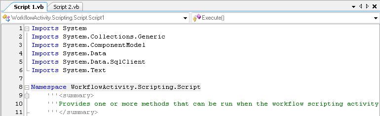

Script Pane
The Script Editor's ClosedScript Pane appears, by default, in the center of the screen and will contain one or more tabs, each of which represents a different script that is currently open. You can write your script in this pane
To open a script in the Script Pane
  • In the Project Explorer Pane, expand the folder the desired script is in and double-click the script.
To navigate within your script
  • At the top of each script, there are two type/member drop-down lists, each of which let you jump to specific areas of your script. In most cases, the left box jumps to classes and the right box jumps to members.
  • You can go to a specific line of code using the Go To feature. To use this feature,
    1. Select Edit from the main menu, and click Go To. Alternatively, use the keyboard shortcut CTRL+G.
    2. In the ClosedGo To Line dialog box, type the number of the line you want to go to.
    3. Click OK.
