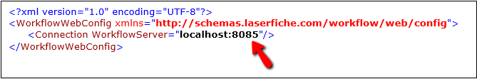

  • Workflow Server port changes: If the Workflow Server's port changes, you must update the port in Workflow Web Service's configuration file. If you don't update the port, unknown errors occur when launching business processes.
  • ClosedSee an example of the error.
    Error Code: 0
    Error Message: Error launching Business Process:
    Entry: Test
    Error Type: Unknown Error
    Error Message: Connection to the Workflow Server 'localhost' could not be created.
  1. Open the following path: Laserfiche\Laserfiche Workflow 9\Web\Laserfiche.Workflow.Web\Config.
  2. Open the Config.xml file and change the Connection WorkflowServer attribute to the port that your Workflow Server is using. ClosedShow me.
