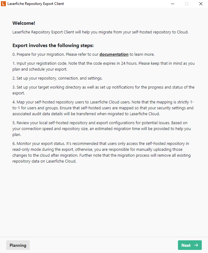

Download and install the latest version of the Repository Export Client on the machine hosting the Laserfiche Server (LFS) service. Ensure that sufficient memory is available for the Repository Export Client to operate if the Laserfiche Server service will not be stopped during the migration.
  1. Start the Repository Export Client. By default, the utility executable is installed at C:\Program Files\Laserfiche\Repository Export Client\RepositoryExportClient.exe.
  2. On the starting step, use the ClosedPlanning option to view general statistics about your Laserfiche repository. The utility will run a Laserfiche volume consistency check, identify any unsupported volumes or features and calculate the amount of data in your repository. Correct any reported errors that block the migration before continuing to the next step.Self-hosted migration instructions
    Important: The repository size estimate is used to estimate how long the migration process may take to complete. This estimate does not reflect the actual storage usage in Laserfiche Cloud post migration due to differing units of measurement. In Windows, 1 gigabyte (GB) is defined as 1,073,741,824 bytes. Laserfiche Cloud uses binary gigabytes (to match how AWS calculates storage usage) where 1 gigabyte (GB) is defined as 1,000,000,000 bytes. This unit of measurement is also known as a gibibyte (GiB) as defined by the International Electrotechnical Commission (IEC). Thus, the gigabyte number of storage size displayed on Cloud may be larger than your local storage size.
  3. Take a screenshot of the planning mode output screen and submit the screenshot along with any generated log files to Laserfiche Support for review. Laserfiche Support engineers will review your submission before approving the migration. Upon approval, solution providers will be able to initiate an import process on behalf of a client and generate a registration code through the Repository Import Monitor.

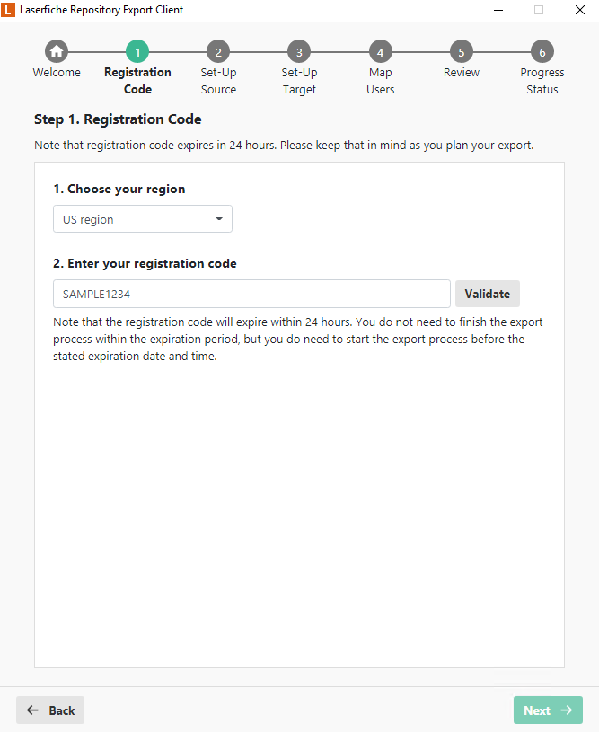

  4. Solution providers can generate a Closedregistration code for the Repository Export Client through the Repository Import Monitor. When signed in to a solution provider account, Select the Repository Import Monitor item from the app picker or from the Overview page. Locate and view the details for the desired account. On the General tab, in the "Next Action" section, use the Initiate Import option to initiate the migration and generate a registration code. The registration code is required for the utility to communicate with Laserfiche Cloud. The code remains active for 24 hours.
  5. Registration Code Step
    Note: If the registration code expires, contact your solution provider or Laserfiche Support to receive a new registration code.

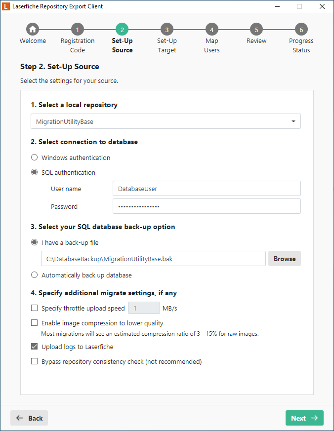

  6. ClosedOn the Source step, configure migration settings for the source repository. If the Enable image compression option is selected, the migration process will compress any uncompressed color images as a preemptive measure to conserve storage space. The compression algorithm is not lossless, but should only rarely have any human-perceptible differences from the uncompressed images. Check the Bypass repository consistency check option only if you have already run the repository consistency check previously and want to skip the step to save time.Set Up Source Step
    Note: When selecting the I have a backup file option, be sure that your backup file only contains ONE single full database backup.
    Note: When selecting the I have a backup file option, the backup file must be an uncompressed backup.

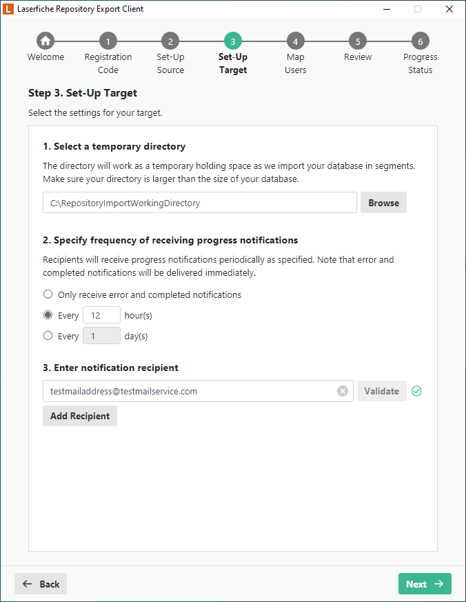

  7. ClosedOn the Target step, configure a target working directory, and choose the type of notifications to receive about the progress and status of the migration process. You can add up to 3 recipients to receive notifications. A test email will be sent to the recipient on email validation. Validate each email address before proceeding to the next step.
    Important: Please have at least 50% of the total repository size available for the local working directory and make sure the directory is empty before starting the migration.
    Set Up Target Step
