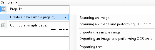

Adding a Custom Sample Page
You can add a custom sample page (image and/or text) to a document class or the Pre-Classification Processing stage of processing so you can test processes and image enhancements on a representative image or text before scanning a large group of documents. Custom sample pages can be added by importing from a network drive or scanning with the scan source you are using for the session. The sample text portion of a sample page can be OCRed from a scanned or imported image or directly imported.
To create a new sample page
Note: If you are configuring sample pages in the Pre-Classification Processing stage, the Samples menu will look a little different. This is because you can configure electronic documents as sample pages in the Pre-Classification Processing stage.
  1. From the Image Toolbar, select Samples. You can also right-click on the sample image or text displayed and hover over Sample Pages.
  2. Hover over Create a new sample page by and select one of the following options:
    • Scanning an image: Select this option if you want to scan images with the scan source you are using for the session. Place a document on the scanner or select a retrieval directory for Universal Capture or Laserfiche Capture Engine. The first available image from the scan source will replace the default sample image. This option will scan in an image only.
    • Scanning an image and performing OCR on it: Select this option if you want to scan an image with the scan source you are using for the session and OCR the image to create sample text from it. Place a document on the scanner or select a retrieval directory for Universal Capture or Laserfiche Capture Engine. The OCR Options dialog box will open.
      1. Select a language from the Language drop-down menu to help optimize the character recognition.
      2. Select an optimization style for your image from the Optimization drop-down menu.
      3. Select Auto Rotate to temporarily rotate the image to an orientation suitable for OCR. After the OCR process is performed, the image will return to its original orientation.
      4. Select Decolumnize to convert multiple columns of generated text into a single column. Clearing the checkbox will preserve column formatting in the OCRed text, even if that separates words and sentences.
    • Importing a sample image: Select this option if you want to import images from a network location. Browse to the location of the image and click Open.
    • Importing an image and performing OCR on it: Select this option if you want to import images from a network location and OCR the images to create sample text. Browse to the location of the image and click Open.
    • Importing text: Select this option if you want to import text only and no image. Browse to the location of the text file you want to import.
      Note: Only .txt files can be imported as sample text files.
    Note: You can also configure sample pages from the Document Class Options dialog box under Sample Pages. See Viewing and Modifying Sample Page Options to further modify your sample pages.

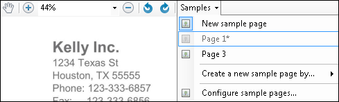

Displaying a Sample Page
If you have added additional sample pages, you can show them in the Display Pane in order to configure and test processes and image enhancements. The last sample page you selected to work with will be automatically displayed. You can change the displayed page by selecting it from a menu or by changing the page range of a process.
Note: In Pre-Classification Processing, you can configure your own sample page or designate the first page of any document class as a sample page.
To select a different sample page from a menu
  1. Click the Samples menu.
  2. Select the page number of the page you want to display. If you have renamed your sample page, select its new name.
Note: You can also right-click on the sample page in the Display Pane to access the Samples Pages menu.
To view a different sample image by changing the page range of a process or image enhancement
  1. Select the process or image enhancement.
  2. Specify a page range.
  3. The first sample image in that page range will be displayed, if any.

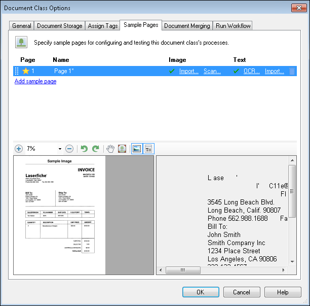

In the Sample Pages tab of the Document Class Options dialog box, you can view the sample page settings for a document class and modify the sample pages to suit your needs.
Document Class Sample Pages

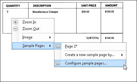

To view and modify Sample Page Settings
  1. Select the name of the document class and do one of the following:
    • From the Samples menu, select Configure sample pages.
    • Right-click on the sample image or text currently displayed, hover over Sample Pages, and select Configure samples pages
      .Confiigure sample pages option
    •  Right-click on a document class, select Document Options, and select the Sample Pages tab.
  2. The Document Class Options dialog box will open to the Sample Pages tab.
    Document Class Options - Sample Pages
To rearrange sample pages
  • Drag the grip icon Grip icon to the left of the page number to the desired location.
To rename sample pages
  • Double-click the page's name under the Name column, type the new name, and press Enter.
To set a sample page as the default
  • Select the star Default Sample Page Star next to the sample page you want to set as the default page. A yellow star indicates that page as the default page.
    Note: The default sample page will be used when you specify a page or page range that does not have a corresponding sample page when configuring a process. For example, if you have sample pages for pages 1 and 2 only, but you configure a process to run on page 3, the default sample page will be used for page 3.
To delete a sample page
  • Click the trash can Trash can button to the right of the page's row.
To add/create another sample page
  • Click Add sample page below the last sample page listed. You will then be able to select Import image, Scan image, Import text, or OCR the sample image at the bottom of the dialog box in the preview area. Scan, import, and OCR as desired.
To replace a sample page with another sample page
  1. If replacing an image, select the page associated with the image you want replaced and click Importor Scanunder the Image column.
  2. If replacing text, select the page associated with the text you want replaced and click OCRor Importunder the Text column.
  3. You will see a preview of the selected sample page (image and text) at the bottom of the dialog box. If you are viewing an image with no OCRed text, you can click Import text or OCR the sample image to generate it. You can zoom in on the image, rotate it 90 degrees to the left or right, and view it in a full-screen window. If you are viewing text with no associated image, you can click Import image or Scan image.
You can assign a sample page to a particular page number. This is useful when you are configuring processes or image enhancements to work on only specific pages of each document.
To assign a sample page a page number
  • Double-click the page number in the Page column. Type the new page number and press Enter.
You can also view or modify sample pages using the Preview Toolbar. This toolbar appears above the displayed sample page.
Preview Toolbar
Item Function
Zoom in Zooms in.
Preset Zoom Displays an image at a preset zoom setting. Select Fit to match the current size of the Laserfiche Scanning window.
Zoom Out Zooms out.
Rotate Left Rotates an image 90 degrees (left).
Rotate right Rotates an image 90 degrees (right).
Pan Pans an image. Drag in the direction you want to review.
Displays the sample image in full screen Displays the selected sample image in a maximized window.
Displays the sample page's image Displays the sample page's image.
Displays the sample page's text. Displays the sample page's text.
