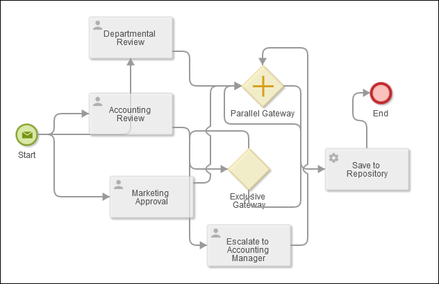

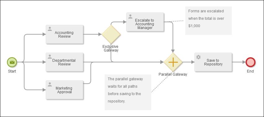

  • Example: These two processes contain the same tasks and automate the same process, but the second one is much easier to work with. ClosedSee the disorganized process. ClosedSee the well-organized process.
    Example of a hard to read process.
    A well-organized process.
