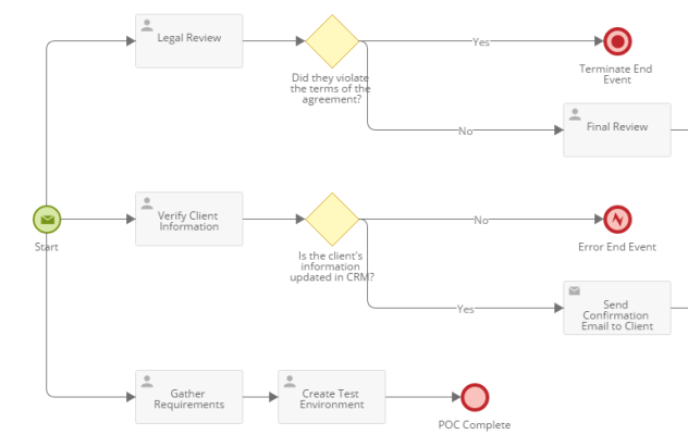

The following example shows how you can use error start events and error end events in a process. In a sales process, the initial submission of a form containing details of a potential sale starts three different process flows. In the first flow, the legal department reviews the prospective sale for any issues. In the second flow, the sales department verifies the client's information. If the client's information is not updated in the Customer Relations Management (CRM) system, an error end event happens. A third process flow starts off a proof-of-concept (POC) demonstration.

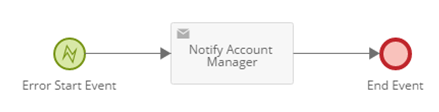

When the error end event in the second process flow occurs, it is caught by an error start event in a separate process flow. This flow leads to the account manager being notified of the outdated client information in the CRM system.

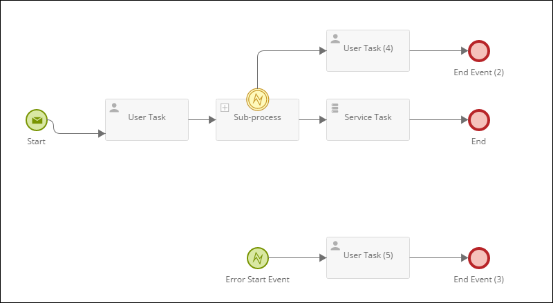

The sub-process is embedded in a main process, as depicted in the next diagram, and has an error catch event attached to it. After being attached to a process, error catch events look as follows:
Sub-process
The error catch event detects when the error end event in the sub-process occurs (that is, when a form with invalid field values is submitted). When this happens, the error catch event triggers the error start event, which terminates the entire sub-process and starts a new process flow.
Larger process containing the sub-process with the error catch event.
If you are not looking for an error inside a sub-process, you do not need to use an error catch event. For errors within the main process, an error end event together with an error start event (as demonstrated in our first example) are enough. The error start event will respond directly to the error end event without having to wait for a signal from an error catch event.
