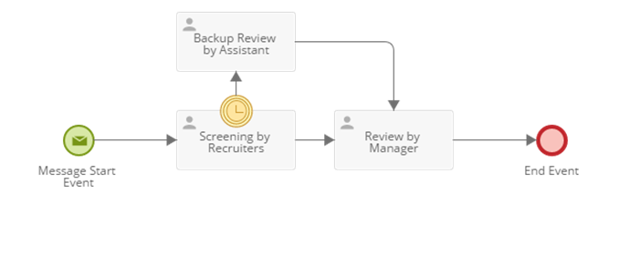

  • Timer catch events can be attached to user tasks to handle deadlines or time constraints. When the deadline has passed, they can cause an alternate flow to be taken. Optionally, they can also interrupt the original process flow.
  • Example: The following diagram depicts a recruiting process. Susan takes care of screening all job applications her company receives. However, if she doesn't get to an application within five business days, then the application is sent to her assistant, Thomas. The process administrator can choose whether the initial process flow that sent the application to Susan is canceled if she misses the deadline. If the process administrator chooses theInterrupt attached activity option when configuring the timer catch event, Susan will not be able to review the application after five business days, and only Thomas can complete the review (i.e. the lower process flow in the diagram below is interrupted). If the process administrator does not choose the Interrupt attached activity option, then the application can still be screened by Susan even after it is sent to Thomas.
Process diagram of timer catch event being used to enforce a deadline.
