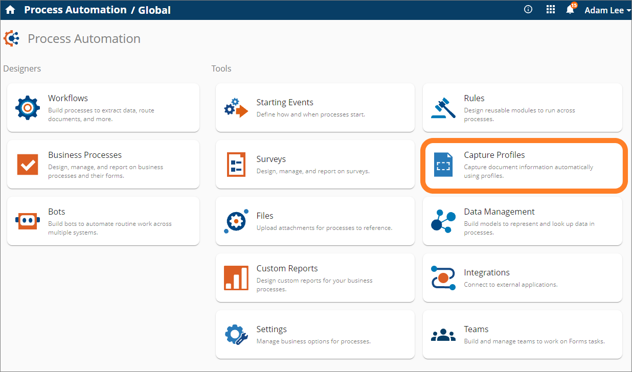

  1. Open the ClosedCapture Profiles page.
    Process Automation Page
  2. On the Capture Profiles page, click Capture Profile in the left pane. You can also click the New button or click the drop-down and select Capture Profile. Additionally, when creating the initial capture profile, you can click ClosedClick here to create a capture profile.

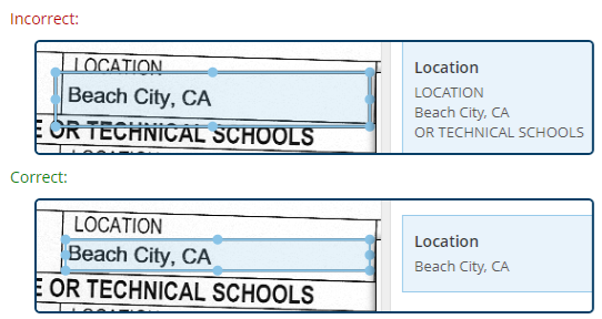

    Note: When drawing or resizing zones, make sure the boundary does not touch any unwanted text. Even text that is partially touching will be fully captured.

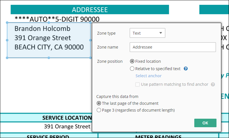

      • Fixed location: If the information will always be in the same location on every scanned page, select Fixed location.

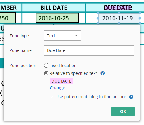

      • Relative to specified text: In some instances, the scanned page may shift and the defined fixed location won't capture the correct information. To account for this, you can select ClosedRelative to specified text, and select some text to anchor the zone to. If the text is shifted on a page, the zone will be shifted by the same amount. For example, if you want to capture someone's name on a document and that name has a "Name" label, you can add a zone over the actual name and anchor that zone to the "Name" label. If the page is shifted when scanned, the profile will look for the "Name" anchor and find the desired text to be captured based on the location (relative distance) of the "Name" anchor.
        Note: When multiple places on a page match an anchor's text, the proximity of each anchor to where that anchor was originally drawn is used to resolve the ambiguity. For example, if the page has a shipping address and billing address, and the anchor text is "address," the profile will use the anchor text that is closest to where you originally drew the anchor on the sample document. If the page only has one instance of the word "address," that text will be used to anchor the zone, no matter where the text is on the page.
        Draw a box around the information you want to capture and anchor it to another bit of text on the page.

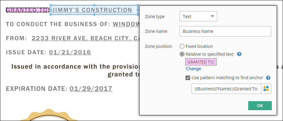

        • Use pattern matching to find anchor: Select Closedthis option if you want to search the document for anchor text using a regular expression pattern. This accounts for instances when the anchor text you want to use to capture data does not always have the same format. For example, business licenses may label the name of the business Name, Business Name, Granted To, Company, etc. By using a pattern to find all the different variants of business name labels, you will be able to capture the business name, regardless of which business name label it follows. Clicking the Pattern Matching button to the right of the pattern text box will aid you when constructing your pattern. It lists helpful character classes, quantifiers, grouping constructs, metacharacters, alternations, and other options.
          Note: By default, the pattern matching anchors are not case sensitive. Use the inline option (?-i) to make them case sensitive.
          Note: The anchor text you select can only span a single line.
    • Capture this data from: If you have multiple sample pages and are defining a zone on the last sample page, you will be presented with this option. If the information you are capturing is always on the last page, even when the documents to be processed have a variable number of pages, select The last page of the document. If you have two pages in a sample document and the data to be captured will always be on page two, regardless of how many pages the document to be processed has, select Page x (regardless of document length).

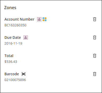

  14. The configured zones and information to be captured will be listed in the Zones pane on the right in the order they appear on the document. Some zones may have an icon next to them to indicate the zone type. Hovering over the icon will give you more information about the zone.
    • A pink anchor icon indicates the zone is anchored to text on the document. Hovering over it will display the text it's anchored to.
    • A pattern matching icon indicates a pattern is used to find text. Hovering over it will display the pattern used to find the desired text.
    • Zones without these icons use a fixed location.
