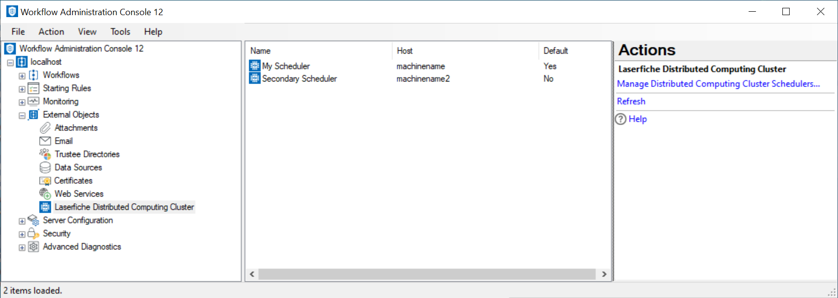

Laserfiche Distributed Computing Cluster Node
This node, under External Objects in the Workflow Administration Console, lets you view the Distributed Computing Cluster Schedulers that are configured to work with workflows on the Workflow Server. You can add, modify, and delete schedulers from this node. Learn more about Laserfiche Distributed Computing.
ClosedShow me this node.
To open this node
  1. In the Workflow Administration Console's Console Pane, expand the External Objects node.
  2. Select Laserfiche Distributed Computing Cluster. The node will list of all the Distributed Computing Cluster Schedulers that are configured to work with workflows on the Workflow Server.
  3. Tip: You can refresh this list to reflect recent changes by clicking the Refresh link below Laserfiche Distributed Computing Cluster in the Actions Pane. Alternatively, right-click the Laserfiche Distributed Computing CLuster node and select Refresh.
To add a Distributed Computing Cluster Scheduler
  1. In the Console Pane, select the Laserfiche Distributed Computing Cluster node.
  2. Click Manage Distributed Computing Cluster schedulers from the Actions Pane. Alternatively, right-click the node or an existing scheduler and select Manage Distributed Computing Cluster Schedulers.
  1. In the Distributed Computing Cluster Scheduler Manager dialog box, click Add.
  2. Configure the Distributed Computing Cluster Scheduler Properties dialog box.
