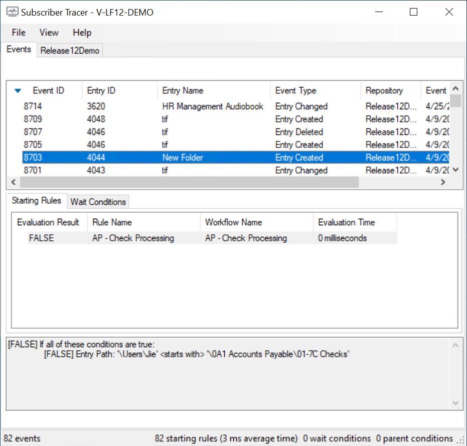

To view starting rule evaluations
- To see how, or if, a starting rule was evaluated for an event, select an event in the Events tab.
- If any of your starting rules are configured to run on the same Event Type as the event you selected, the Starting Rules tab will display how the rules were evaluated. The Starting Rules tab shows the Evaluation Result, Rule Name, Workflow Name, and Evaluation Time.
- You can view the complete evaluation of each aspect of the starting rule in the gray Condition Trace box below the Starting Rules tab.
Example: You have a starting rule named "Copy and Approve" that runs when an entry is copied and its Status field is set to approved. If the event you selected in the Events tab was an Entry Copy event, then the "Copy and Approve" rule's evaluation would show in the Starting Rule tab. If an entry was copied but the Status field was not set to Approved, the rule would be evaluated as false. If the entry was copied and the Status field was set to Approved, the rule would be evaluated as true.

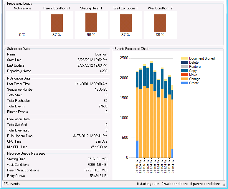

To view additional data about the events in a repository
- The Subscriber Tracer will show a tab for each repository the subscriber is monitoring.
- Click a repository's tab to see
additional information about events occurring in the repository.
- The tab displays Processing Loads charts, the Subscriber Data, the Notification Data, the Evaluation Data, the number and size of Message Queue Messages, and an Events Processed Chart.
Note: The screenshot revealed by clicking additional information in step 2 shows a Subscriber under high load.

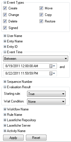

To search for events
- Select View from the main menu.
- Select Show Filter.
This pane allows you to search by Event Types, User Name, Entry Name, Entry ID, Event Time, Sequence Number, Evaluation Result, Workflow Name, Rule Name, Laserfiche Repository, Laserfiche Server, and Activity Name. Expand and configure the desired search types.
- Click Apply to search.
- Optional: Click Reset to revert to the default configuration.
