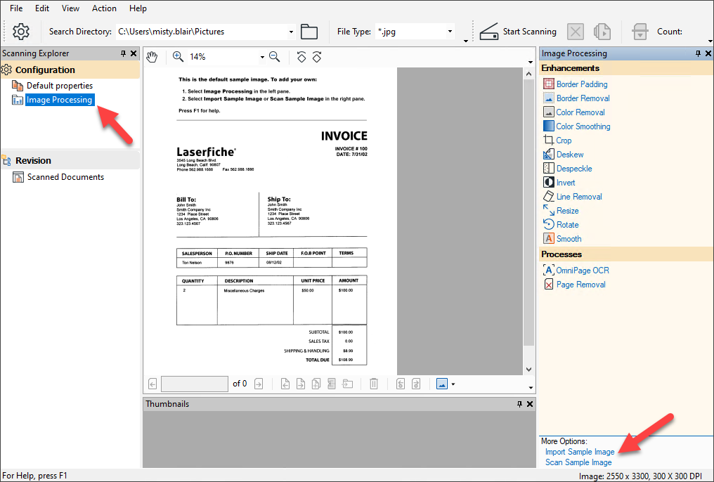

Scanning or Importing a Sample Image
A custom sample image allows you to test image enhancements before scanning. For best results, sample images should be as similar as possible to the pages you want to scan.
To add a sample image for testing, select Image Processing under Configuration in the upper left corner. At the bottom of the Image Processing pane on the right, select either Import Sample Image or Scan Sample Image.

To configure image enhancements
  1. Select Image Processing under Configuration in the upper left corner.
  2. Available enhancements and processes will be listed under Image Processing on the right side of the screen. Click a process to add it to the process list.
