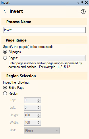

  1. In the Session Configuration Pane, select the stage of processing where you want to use Invert.
  2. In the Tasks Pane, select Invert.
  3. You can optionally enter a name for the process under Process Name.
  4. Move through each step of the wizard at the bottom of the pane. You can also click Skip Wizard to display and configure the properties all at once.
  5. Page Range: When configuring an image enhancement in Page Processing or Post-Processing, you will be prompted to specify a page range. In other stages, default settings will automatically be applied.
  6. Region Selection: Specify the region that will be inverted. You can invert the entire page or a selected region. To define a region, select Region and either drag and resize the zone on the Display Pane or specify coordinates in pixels or by percentage in the in the Tasks Pane.
