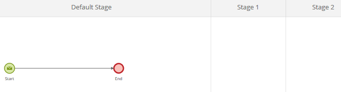

Stages
Default stage in a process diagram
The process diagram also contains stages, which are regions of the diagram separated by vertical lines. For example, in the screenshot above, the depicted process is located entirely within the Default Stage, with Stages 1 and 2 being blank. Stages can be used to visually organize a complicated process. Stages do not affect how processes actually run—you can put any process entirely in one stage, or spread it over several stages, without changing how it runs.
