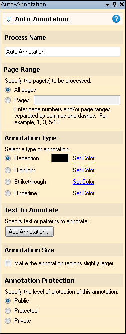

To configure Auto Annotation
  1. In the Session Configuration Pane, select the stage of processing where you want to use Auto-Annotation.
  2. In the Tasks Pane, select Auto-Annotation.
  3. You can optionally enter a name for the process under Process Name.
  4. Move through each step of the wizard at the bottom of the pane. You can also click Skip Wizard to display and configure the properties all at once.
  5. Page Range: When configuring this process in Page Processing or Post-Processing, you will be prompted to specify a page range. In other stages, default settings will be automatically applied.
  6. Annotation Type: Select a type of annotation. Annotations available in Quick Fields have the same properties as the same annotations applied in the Laserfiche repository.
    • Redaction
    • Highlight
    • Strikethrough
    • Underline
    For each annotation type, you can click Set Color to change the color or create a custom color.
  7. Text to Annotate: When you click Add Annotation, the New Annotation dialog box will appear.
    • Specify a name for the annotation that will help you remember its function when reviewing the session later.
    • Specify the text to annotate.
      • You can specify text—for example, if you want to highlight a particular word.
      • You can select the pattern button to use pattern matching expressions to annotate any text that matches a particular pattern (such as a social security number).
      • You can manually enter a token into the Pattern box. This will account for patterns that are different per document. For example, if you want a different client name redacted on each document, input the %(Field.ClientName) token into the Pattern box.
      • No token picker is available, therefore, you must manually input the token syntax.
      • Select Test to enter a sample value and see whether the regular expression works.
    • Specify a description that will help you remember the purpose of the annotation and the regular expression when reviewing the session later.
    • Click OK.
    • When you click on the summary of the annotation, the Edit Annotation dialog box will appear and you can modify any of these settings.
  8. Annotation Size: When Make the annotation regions slightly larger is selected, the annotation will become slightly larger. This can help ensure redacted data is fully covered.
  9. Optional: To preview how this enhancement will affect scanned images and OCRed or extracted text, test processes. For the best results, add a custom sample page before testing. Adjust and test until you are satisfied with the results.
  10. Annotation Protection: Select if you want the annotation applied to be
    • Public: The annotation will be visible to everyone.
    • Protected: The annotation can only be modified by its creator or document owner.
    • Private: The annotation will only be visible to its creator.
