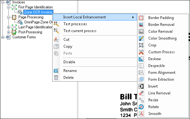

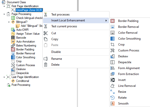

To add a local image enhancement
  • Right-click on the process in the Session Configuration Pane, point to Insert Local Enhancement and select the enhancement you want to use.
Example: Earl wants to use OmniPage Zone OCR to extract information from a document that has been scanned in color, but wants to retain the color when the document is stored in Laserfiche. He configures Color Removal as a local enhancement within the OmniPage Zone OCR process to improve the results while retaining the color on the stored document.
