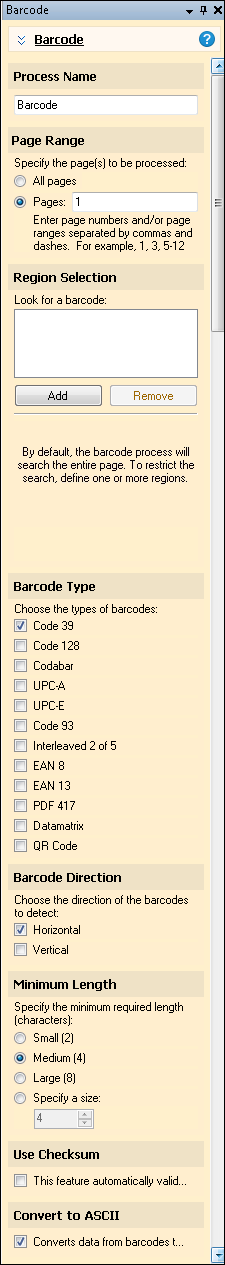

To use Barcode
  1. In the Session Configuration Pane, select the stage of processing where you want to use Barcode.
  2. In the Tasks Pane, select Barcode.
  3. You can optionally enter a name for the process under Process Name.
  4. Move through each step of the wizard at the bottom of the pane. You can also click Skip Wizard to display and configure the properties all at once.
  5. Page Range: When configuring a process in Page Processing or Post-Processing, you will be prompted to specify a page range. In other stages, default settings will be automatically applied.
  6. Region Selection: By default, the barcode process will search the entire page. To restrict the search, define one or more regions.
    • To define a region, click Add and either drag and resize the zone on the Display Pane or specify coordinates in pixels or by percentage in the Tasks Pane.
      Tip: If you are zoomed in to a specific area of an image, adding a zone will place it in the top left corner of the zoomed in image for convenience.
    • Specify a name for the region. This will also be the name of the token that represents the value extracted from the barcode in the region.
    • To define an additional region with the same settings, click Add again.
    • To remove a barcode region, click Remove.
    Note: Zones can be copied and pasted within this and other processes that contain zones. When copying a zone within this process, pasting using CTRL + V will paste the zone directly on top of the zone you copied. Right-clicking on a different area of the image and selecting Paste Zone from the context menu will paste the copied zone where you right-clicked.
  7. Identification Condition: When configuring Barcode in First Page Identification or Last Page Identification, you will be prompted to set an identification condition, such as whether there is a barcode in that region or whether it contains a particular value.
  8. Barcode Type: Choose the types of barcode to be read. If you have multiple types of barcodes or are not sure what types you have, you can select many types. Selecting fewer types will help the process run faster.
  9. Barcode Direction: Select the direction to scan the barcodes.
    • Horizontal: Barcodes will be scanned from right to left.
    • Vertical: Barcodes will be scanned from top to bottom.
    • Both: Both settings will apply. This is useful if you have multiple barcodes in different directions.
  10. Minimum Length: Specify the minimum number of characters a barcode must contain to be recognized as valid by this barcode process.
  11. Use Checksum: If the barcodes you are reading include checksums designed to help confirm the data has not been corrupted, you can select this option to examine the checksums.
  12. Convert to ASCII: Certain types of bar codes start or end with special characters that are normally ignored. These types of characters may prevent a bar code from being read. This option allows those characters to be recognized and included in the value extracted by the bar code process.
