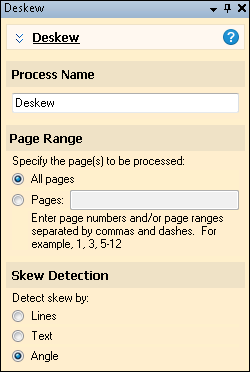

To use Deskew
  1. In the Session Configuration Pane, select the stage of processing where you want to use Deskew.
  2. In the Tasks Pane, select Deskew.
  3. You can optionally enter a name for the process under Process Name.
  4. Move through each step of the wizard at the bottom of the pane. You can also click Skip Wizard to display and configure the properties all at once.
  5. Page Range: When configuring an image enhancement in Page Processing or Post-Processing, you will be prompted to specify a page range. In other stages, default settings will automatically be applied.
  6. Skew Detection: Specify a method to determine how skewed an image is.
  • Lines: Estimates using the degree by which lines run parallel to the corresponding image border.
  1. Text: Estimates using text. Text must run left to right.
  2. Angle: Estimates using the foreground (everything black on the black and white image, including lines, text, and pictures).
