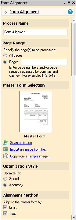

To configure Form Alignment
  1. In the Session Configuration Pane, select the stage of processing where you want to use Form Alignment.
  2. In the Tasks Pane, select Form Alignment.
  3. You can optionally enter a name for the process under Process Name.
  4. Move through each step of the wizard at the bottom of the pane. You can also click Skip Wizard to display and configure the properties all at once.
  5. Master Form: The master form is an image of a blank form that matches the forms you will be processing. In Form Alignment, the lines and text on the master form will be matched to those on the scanned forms to make the data easier to read. There are three ways to add a Master Form:
    • Scan: Scan in the master form using the currently configured scan source.
    • Import: Import an image that is currently stored in a network drive.
    • Copy from a sample image: If you have already added a custom sample image that is the same image you want to use as the master form, you can copy it.
  6. Page Range: When configuring an image enhancement in Page Processing or Post-Processing, you will be prompted to specify a page range. In other stages, default settings will automatically be applied.
  7. Optimization Style: Choose whether to optimize the Form Identification process for Speed or Accuracy. This setting will not have much effect on images that are completely different from the master form. However, optimizing for accuracy can make a difference when trying to distinguish between two similar forms.
  8. Alignment Method: Choose which components of an image will be used to match it to the master form.
    • Lines: Use lines to match the image to the master form.
    • Text: Use text to match the image to the master form (horizontal text only).
    • Lines & Text: When both Lines and Text are selected, lines will be used first. If the lines do not clearly identify a match, the text will be used to match the image to the master form.
