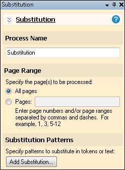

  1. In the Session Configuration Pane, select the stage of processing where you want to use Substitution.
  2. In the Tasks Pane, select Substitution.
  3. You can optionally enter a name for the process under Process Name.
  4. Move through each step of the wizard at the bottom of the pane. You can also click Skip Wizard to display and configure the properties all at once.
  5. Page Range: When configuring a process in Page Processing or Post-Processing, you will be prompted to specify a page range. In other stages, default settings will be automatically applied.
  6. Substitution Patterns: To configure a pattern, click Add Substitution. The New Substitution Pattern dialog box will open.
