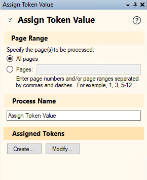

  3. You can optionally enter a name for the process under Process Name.
  4. Move through each step of the wizard at the bottom of the pane. You can also click Skip Wizard to display and configure the properties all at once.
  5. Page Range: When configuring this process in Page Processing or Post-Processing, you will be prompted to specify a page range. In other stages, default settings will be automatically applied.
  6. Assigned Tokens: Click Create to create a new token or Modify to update an existing token.

    1. Click Create in the Assigned Tokens property box.
    2. In the Create New Token dialog box, type a name for the new token next to Create a new token named.
    3. Optional: Select the checkbox next to Allow token to have multiple values to create a multi-value token.
    4. Type in a token value, or click the token button (right arrow) to use tokens. You can select Token Dialog from the token button drop-down menu to modify and format tokens.
    5. Click OK.

    1. Click Modify in the Assigned Tokens property box.
    2. In the Assign Token Value dialog box, select the process that produced the token you want to modify from the Process drop-down menu.
    3. Select the token from the Token drop-down menu.
    4. Type in a new value for the token, or click the token button (right arrow) to use tokens. You can select Token Dialog from the token button drop-down menu to modify and format tokens.
    5. If modifying a multi-value token, you can select if you want to replace the existing values or append to them.
    6. Click OK.
