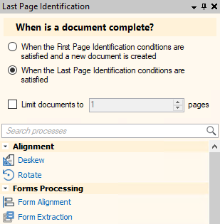

To change the Quick Fields document length settings
  1. Select the Last Page Identification stage under the desired document class.
  2. In the Tasks Pane, specify the desired settings under When is a document complete?.

  2. In the Tasks Pane, select if you want the document to be defined as complete when the First Page Identification conditions are satisfied or when the Last Page Identification conditions are satisfied. You can also select when a certain number of pages have been assigned to a document. The following steps assume you select when the Last Page Identification conditions are satisfied.
    Select when a document is complete using first page or last page conditions

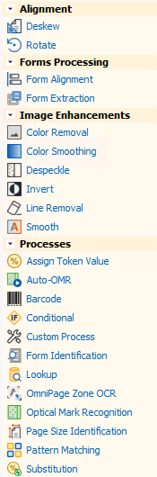

  3. Select the name of the process.
    Last Page ID Processes
