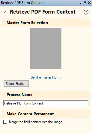

To use Retrieve PDF Form Content
- In the Session Configuration Pane, select Pre-Classification Processing.
- In the Tasks Pane, select Retrieve PDF Form Content.
- You can optionally enter a name for the process under Process Name.
- Move through each step of the wizard at the bottom of the pane. You can also click Skip Wizard to display and configure the properties all at once.
- Master Form Selection: The master form is a blank copy of the exact form being processed. This is needed to define which form fields to retrieve. Click Set the master PDF to select the master form.
- Select Fields: Selecting fields allows you to choose the PDF form fields you want to retrieve values from. Click Select Fields to open the Retrieve PDF Field Values dialog.

- Make Content Permanent: Select Merge the field content into the image if you want the field content merged into the image, converting the PDF form to a regular unalterable PDF.
