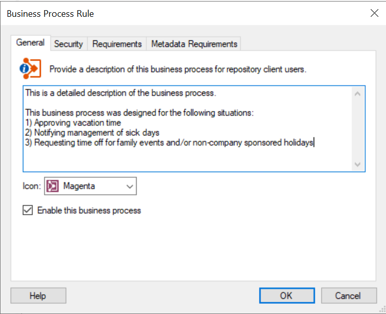

To configure the General tab
- From the
General tab, type instructions, or a summary, for the business process. This information will appear in the Start Business Process dialog box in the Laserfiche client applications.Tip: Providing a comprehensive description will allow users who can see the business process in the Laserfiche client applications to understand the intended use of the business process and what requirements must be met before it can be run.
Note: Instructions are limited to 1,024 characters.
- If you are creating a business process for future use or you want to disable the business process, clear the Enable this business process checkbox. This will disable the business process so that it cannot be run manually on any entry in the Laserfiche client applications.
- Optional: The Icon drop-down menu lets you choose an icon color for your business process. Icons appear in the Laserfiche client applications and can be used to create custom toolbar buttons.
- When you have finished configuring the General tab, select Security Policy and/or Requirements. Alternatively, click OK to save your changes and close the dialog box.
