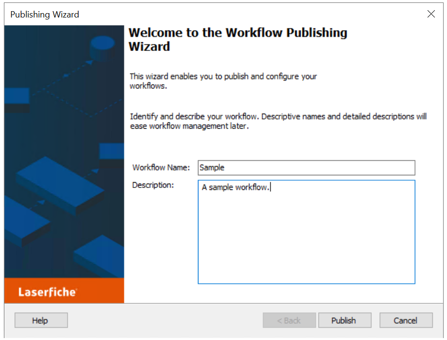

Using the Publishing Wizard
  1. Ensure the workflow you want to publish is visible in the Workflow Designer.
  2. Under Workflow in the main menu, point to Publish and select Launch Publishing Wizard. Alternatively, use the keyboard shortcut CTRL+SHIFT+W.
  3. In the opening screen of the Publishing Wizard, type in a Workflow Name and optionally a Description.
  4. Publishing wizard
  5. Click Publish.
  6. If your workflow cannot be published, you will see a list of validation errors that need to be fixed in the workflow or receive an error message. If your workflow successfully publishes, you will be prompted to create a starting rule.
    • Select the Create a starting rule after publishing checkbox, and click Next to use the Rule Wizard to create a condition or schedule starting rule.
    • Clear the Create a starting rule after publishing checkbox, and click Finish to publish without creating a starting rule.
    • Note: A published workflow must be assigned a starting rule before it becomes operational unless it is invoked by another workflow.

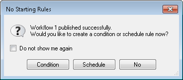

  5. If you have not configured a starting rule for the workflow, you will be prompted to create a starting rule.
  6. Prompt to create a starting rule
    • Click Condition or Schedule to create a condition or schedule starting rule.
    • Click No to publish a workflow without creating a starting rule. Workflows without starting rules will not run unless they are invoked by other workflows.
    • Check Do not show me again, to no longer see this prompt dialog box when publishing a workflow without a starting rule.
    • Note: You can configure which prompts are shown or hidden in the Prompts node of the Options dialog box.
